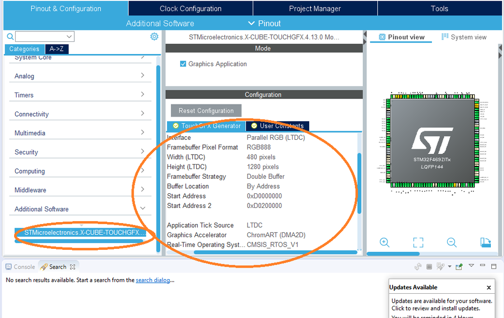

2020-09-07 8:01 AM
On point 4 i mean add and set parts on image.
On 6 you need add lines to main.c, because generated code not start TouchGFX, maybe newer MX do it , but my 5.6 generate empty defaultTask
without add task no touch start exist...
void StartDefaultTask(void const * argument)
/* USER CODE BEGIN 5 */
MX_TouchGFX_Process(); //added line
/* Infinite loop */
for(;;)
osDelay(1);
/* USER CODE END 5 */
BSP --- Cube clean project dont create it , you need add (copy) files when you need any. For my project i only create new driver for my LCD.
POINT 7 : block rtos start comment it out and add some test as backlight on some pixels on display change ...
/* Start scheduler */
// osKernelStart();
/* We should never get here as control is now taken by the scheduler */
/* Infinite loop */
/* USER CODE BEGIN WHILE */
//test here
while (1)
/* USER CODE END WHILE */
/* USER CODE BEGIN 3 */
/* USER CODE END 3 */
