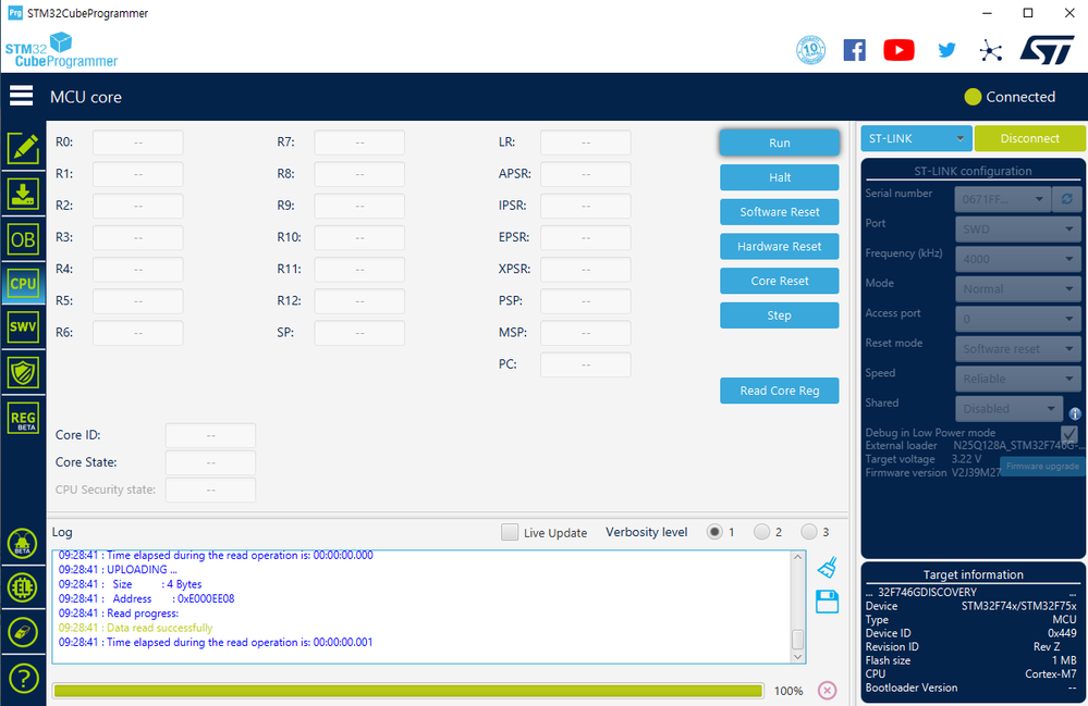

2022-11-17 4:29 PM
I have the same problem.
Only the "touch screen" doesn't work.
My board doesn't work with hardware reset, but it works with STM32CubeProgrammer.
What is the reason for this?
