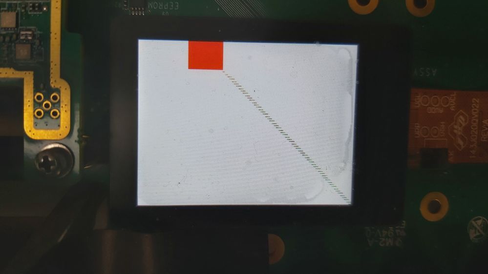

2022-06-05 11:32 PM
hello, Yoann.
I added an image that shows the dots left by the animation of moving the box through the screen.
thanks.
2022-06-06 5:42 AM
Hello Eblec,
Try use <box>.invalidate() for the background box and execute it in each tick event
2022-06-06 6:09 AM
thanks. I'll try this. but isn't it a workaround to fix an animation problem ?

2022-06-07 12:58 AM
hello, Oskt.
it works fine on the disco, which has 240*240 screen.
it leaves dots on my custom board with a screen 320*240.
I declare in touchGFX the 320*240 , and only the animation leaves dots.
thanks.
