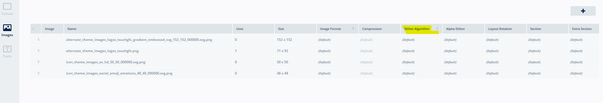

I understand, have you tried to change the Dither Algorithm? Maybe it can help you to make your image look better.
