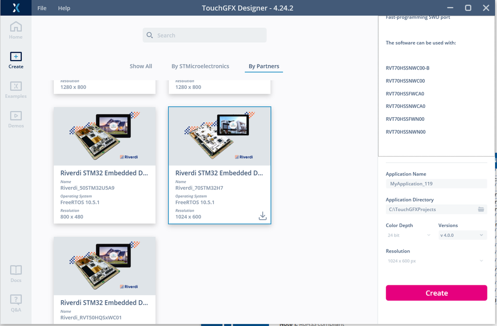

Hello Pawel,
I am not sure what you mean by your edit. The board should work fine with TouchGFX. The designer even includes a board setup that should work as shown in the picture.
Using that, are you able to make a UI, flash it and have touch input work?

Hello Mathias,
With my edit I mean the version of Touchgfx should be 4.24.2, version of Riverdi software v4.0.0 and the most important: you can't generate code with CubeMX. You do it once and your project is damaged and can't build anymore. So if you need to do some changes, you have to do it per hand.
Best regards, Pawel.
