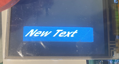

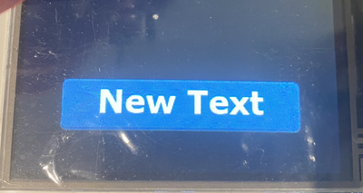

On the initial draw of the entire screen, everything was displaying correctly, but as soon as an individual element (button, text box, etc) needed to be redrawn (“invalidated”), it would display distorted, or at a slant:
Before button was pressed:
After button was pressed:

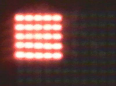

If you were to look closely at the bottom right corner of the pressed button (I did it with a magnifier), you would be able to see some missing pixels (or really the wrong color). This made me think I was somehow missing or skipping pixels whenever I redrew anything smaller than the entire screen.

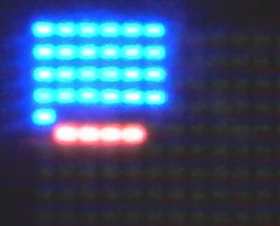

To test this, I drew a 5 pixel by 5 pixel box at the upper left hand corner of my screen initially colored red:
I then setup an interaction for that screen in TouchGFX designer to call a virtual function every 10 ticks (1 second in my application). On each tick, I toggled the screen between green and blue.
So as it turned out, redraws of areas smaller than the entire display were resulting in the image being drawing 1 pixel too far to the right, and subsequent rows were ending up with the image shifted one pixel to the left per row, resulting in the slanted display.
