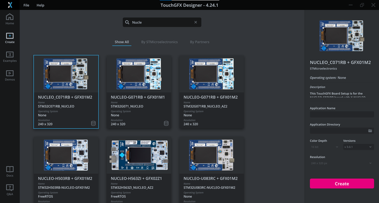

There are a couple of TouchGFX Board Setups (TBS) available in the TouchGFX Designer that use no operating systems like NUCLEO_C071RB
NUCLEO_C071RB TBS
You can also try using handleTickEvent() instead of calling the update value function from the Model
