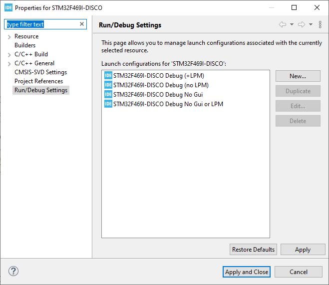

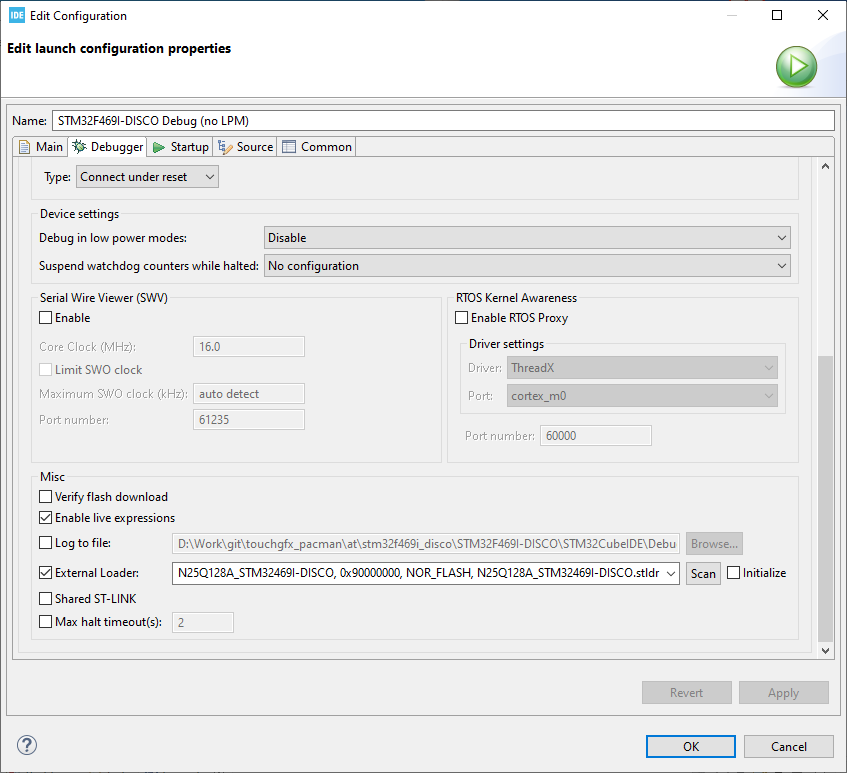

Roman,
Since you say you are new to this, I thought I'd show you where that external loader is selected and enabled. You need to select and edit a Launch Configuration from the Run/Debug Settings under your Project->Properties:
Then on the Debugger Tab, scroll all the way down and you will see the external Loader option (mine is a different file than yours).
Also, to optimize loading time, you can copy your Launch Configuration and modify it to NOT enable the external loader. Whenever you make GUI changes and then want to debug, use the configuration with the loader enabled. If no GUI changes have occurred since your last debugging session, use the configuration with the loader disabled. There is no need to have the external loader run if you already have the latest GUI changes in flash.

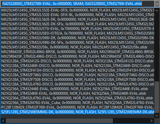

2022-05-17 10:39 PM
Hey egoltzman,
thanks for your replay. I can't evene find this kind of external QSPI. I chosed another one, at the very beginning, and it seems to not work properly:
I've had S25FL128S_STM32WB5MMG-DK, 0x90000000, NOR_FLASH, S25FL128S_STM32WB5MM-DK.stldr selected.

2022-05-18 4:46 AM
I don't think your selected loader will work - it looks like the QSPI flash is a S25FL128S model, whereas I believe the display module contains an MX25L6433F model. egoltzman seems to have the correct loader identified, so you need to determine why it is not showing up in CubeIDE. Do you have the X-CUBE-DISPLAY 2.0.1 software component selected as described in the Designer when the board setup is selected? If so, I would reach out to ST tech support. I haven't used this eval board, so I'm out of ideas. Good luck.
