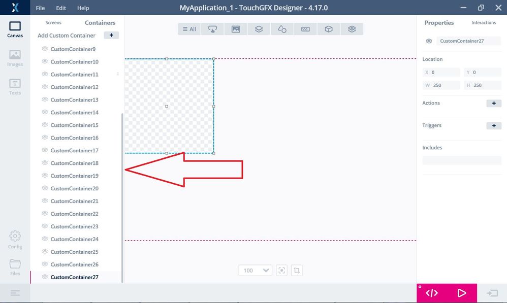

Hi, I want to report a problem in TouchGFX Designer, when a project has some widgets and containers in the custom containers tab and it needs to scroll down in the left bar, when I scroll down to the end of the list by mouse scroll wheel, the designer doesn't response to anything anymore and has to be terminated by the task manager.

Thank you for reporting this. It is a known issue we are working on. Could you share your project ? I cannot seem to replicate this issue, but you are not the first one that face it.
/Romain
2021-09-09 4:24 AM
Could you also share your logfile after facing the issue ? It is found under %appdata%/Roaming/TouchGFX-4.17.0

I think it's about PC resolution. When I set the resolution to 1680x1050 I have the problem but any other values don't. So why when I uninstall the GPU driver the problem solves? Because the resolution will set to the default value (800x600).

We have the same problem with version 4.18.1. It seems to appear only with high screen resolutions (2560x1440). With a resolution of 1920x1080 the problem does not occur.

Hello LHill.2,
Thanks for these information. We have investigated that issue and we think the issue can be related to the "Scale an layout" parameter on Windows Settings. Indeed, we can reproduce the bug when we have "125%" value for example, but we can't reproduce it with "100%" value. Can I ask you what's your "Scale and layout" value on your Windows settings ?

Hello Osman,
You are right, using the 125% setting causes the problem. With a scale of 100% it works fine, regardless of the screen resolution:thumbs_up:
