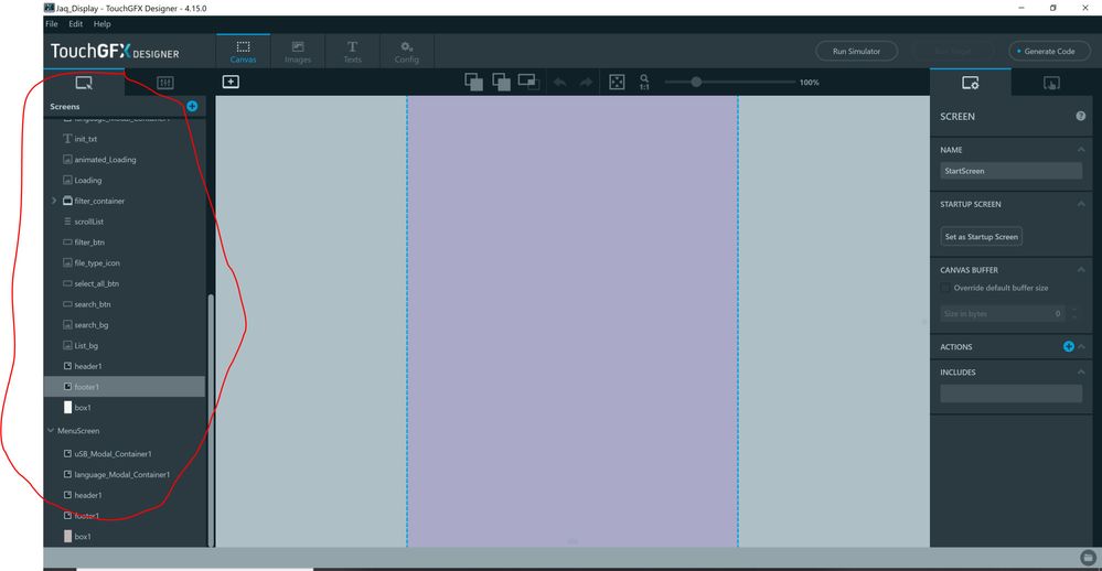

If I expand screens tab on left column and there are many widgets added to a screen or there are multiple screens which requires to scroll down that list then TouchGFX Designer 4.15 gets hanged when you reach at end. Only fix then is to kill this Designer.
As a workaround this bug, I had to group various widgets on a screen to different containers so that my over all list is small and I will then only expand the specific container I am currently working. The basic idea is that the list should not be expanded enough that it occupies the entire screen and you don't scroll down till end otherwise it hangs.
Please refer to attached image in which I have highlighted the menu I am referring to.

I am not sure if I can share the project or not. But I created another dummy project to reproduce the issue and have attached it. In order to see these issue you need to have at least 2 screen and add any widget in any screen. Add widgets till that list is big enough so that you have to scroll down to see the last widget. Once you reach the end in scrolling down the list, Designer gets hanged. What I mean by hang is it will not reply to any clicks not even to close it. I need to use Task manager on my windows PC to kill the Designer App. Also, in Task manager I can see that Designer is using like 20-30% of my CPU.
I am guessing that in this scenario when you scroll down at the end of list it gets stuck in some loop or something which is using large amount of CPU and its stops responding to any clicks.

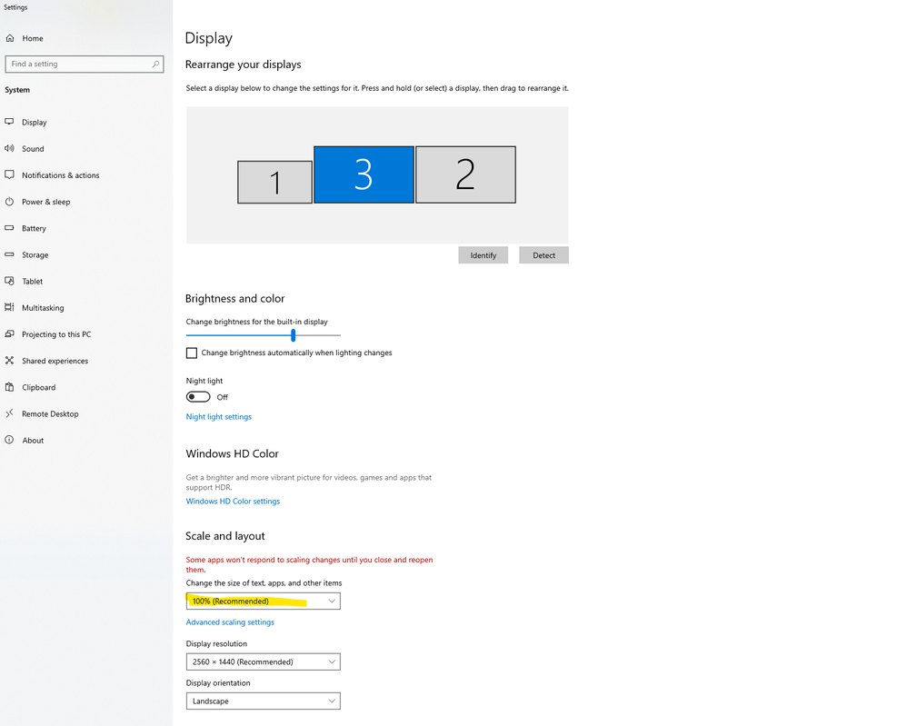

Hello SGK,
Could you check which scale you use in your Windows display settings?
I do remember it was related to smthg with this value. Using 100% should be ok, but 125% causes the issue.
I'm talking for versions of Designer below 4.20.0 because it's supposed to be resolved since 4.20.0.
