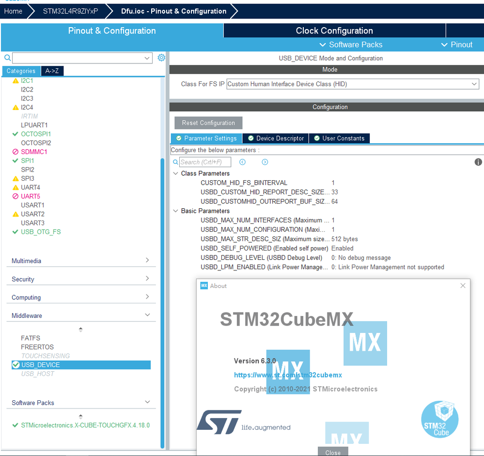

2021-10-28 1:06 AM
What version of STM32CubeMX and TouchGFX are you using by the way ?
What MCu are you using ? Could you share a screenshot of how you configured the USB in STM32CubeMX ? (so that I can save some time)
/Romain
2021-10-28 4:59 PM
STM32CubeMX V6.3.0
TouchGFX Designer V4.18.0
The files in the red box are deleted when regenerate UI code by TouchGFX Designer.
