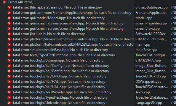

I have the same issue on a dual core M7/M4. It is not finding the .cproject file in the root. Which isn't there. The .cproject file exists in the M7 directory along with the ToughGFX folder.
I copied the .cproject file from the M7 directory to the root and that seems to solve the problem in TouchGFX designer, but the paths are complete messed up when you compile them in CubeIDE.

Dual core projects are always a bit more complex :grinning_face_with_sweat: Did you start a project from STM32CubeMX or did you use a TouchGFX Board Setup for the STM32H747 dk board and modified it ? If the first (which is the best process) I would still suggest to create a project with the STM32H747dk example to compare the files and settings.
/Romain
2022-12-07 8:07 PM
I tried all. The project generation from STM32CubeMX in my preference, but it doesn't work. I've generated a working project from TouchGFX but I DO NOT like the virtual folders and files that it uses in STM32CubeIDE.
I will generate both but I'm not really interested in modifying a file each time I re-generate the project. Would love to see it fixed.
2022-12-07 9:26 PM
Could you elaborate a bit more on what you would prefer to have ? So that we can see what we can do ? Without your project it is a bit difficult to truly find the issue. I remember struggling a lot creating the TouchGFX Board Setup for the stm32h747dk and eval with my colleagues so I completely understand the struggle :grinning_face_with_sweat:.
/Romain
