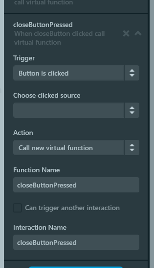

I made an interaction for a Flex button to call a function with TouchGFX Designer 4.15.0.
I closed TouchGFX Designer and reopen the project file that I saved, the interaction is not bound to any button. (See the image below)
When I press [Generate Code] button on TouchGFX Designer, the interaction in ViewBase class is overwritten and deleted.
However .touchgfx file is not changed at all, so I can see the interaction is bound to button if I open the project file with text editor.
This bug does not always occur. and other interactions in the same screen or the other screen is not affected.

I tried with 4.16.1 and it doesn't change at all.
I open the project file with Designer, the clicked source field of interaction for "closeButton" is already empty.
But as you can see the image attached the first post, the instruction text (When closeButton clicked call virtula functrion) is correct.
I didn't do anything except open the project file to reach this behavior.
