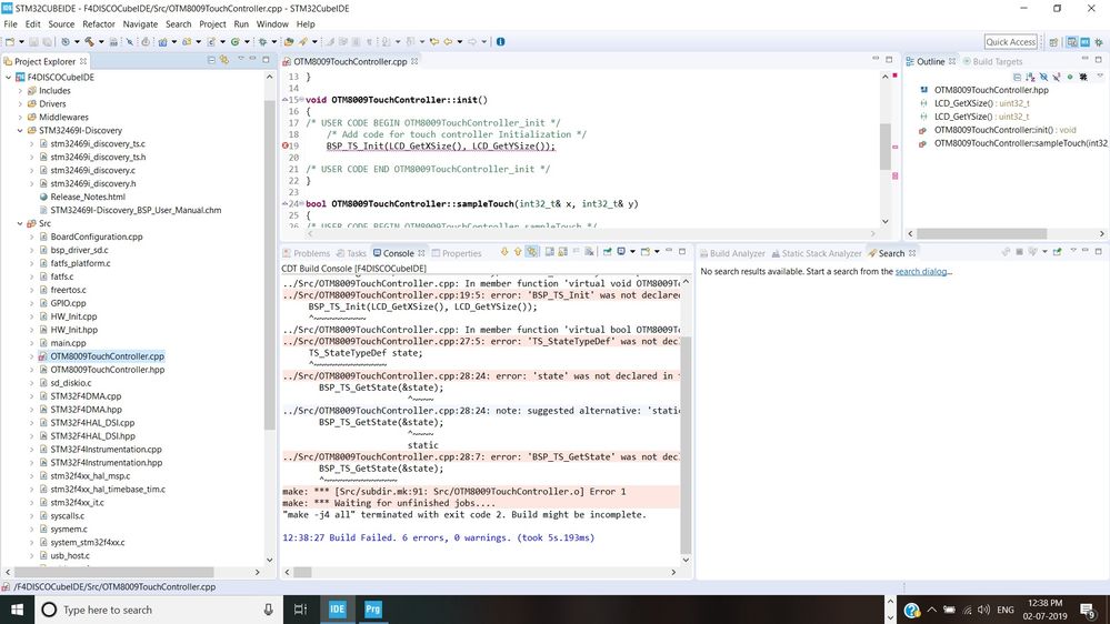

2019-07-02 11:15 PM
Already Included
Here i enclosed the Image
2019-07-02 11:59 PM
Yeah, those methods are a part of the Discovery Firmware pack. You need to add it manually ( _discovery.c and _ts.c). Also the include path, of course.
