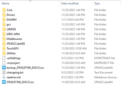

An exemple of a project/TouchGFX folder structure : TouchGFX Designer Project | TouchGFX Documentation

With dual core you have two folders for each cores (CM4 and CM7). It's the same as for single core, except that the TouchGfx related folders will be placed on the context (core) you set in CubeMX.
