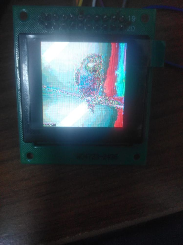

I have already integrated Touch GFX and the driver I am using takes input in the form of uint8_t. The driver function for drawing a bitmap is:
HAL SPI Transmit(&hspi3, (uint8_t*) image, 40960, 10);
However, the Touch GFX frame buffer is in constant uint16_t* format, accessed via the get client frame Buffer(); function. To match the driver input, I typecast the framebuffer to constant uint8_t*:
(constant uint8_t*) get client frame buffer();
Despite this, the image displayed on the OLED screen appears distorted. I suspect the issue lies in the way the 16-bit frame buffer is being handled by the driver, as it expects 8-bit data.
Can you please help me understand the cause of this distortion and suggest the best approach to resolve it?
2024-10-11 4:20 AM - edited 2024-10-11 4:23 AM
@jijomathew wrote:However, the Touch GFX frame buffer is in constant uint16_t* format, accessed via the get client frame Buffer(); function. To match the driver input, I typecast the framebuffer to constant uint8_t*:
Typecasting a pointer won't change the data.
You probably need to change byte order.
You do this by modifying the original buffer or by creating a separate buffer with the converted values.
Some L4 models contain hardware acceleration (chromart) that can potentially help with this. But since you refused to answer my question I don't know what model you have.
@jijomathew wrote:the OLED screen appears distorted.
Please upload a photo of this.

Primary question is your LCD SPI mode 3wire or 4wire? You show sending 8bit , then seem 4wire, but check.

2024-10-11 5:41 AM
Looks like color bits are mixed up. What's the original image? Perhaps you can try a different test image such as a rainbow.
