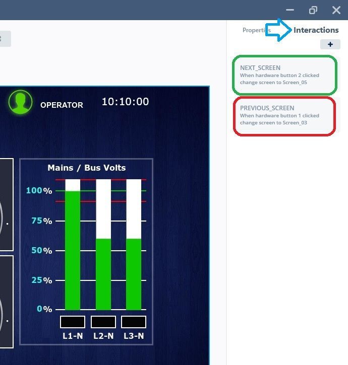

For screen changing in sequence or jumping to any screen , Interaction feature is used.
I use 2 Interactions for each screen (accept first and last screens) as NEXT_SCREEN & PREVIOUS_SCREEN

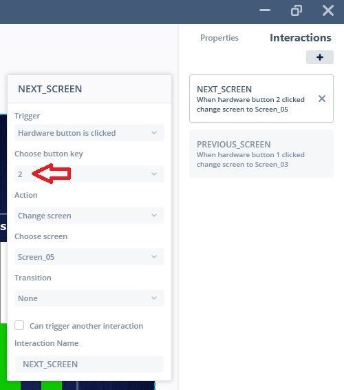

For NEXT_SCREEN Interaction , below is example

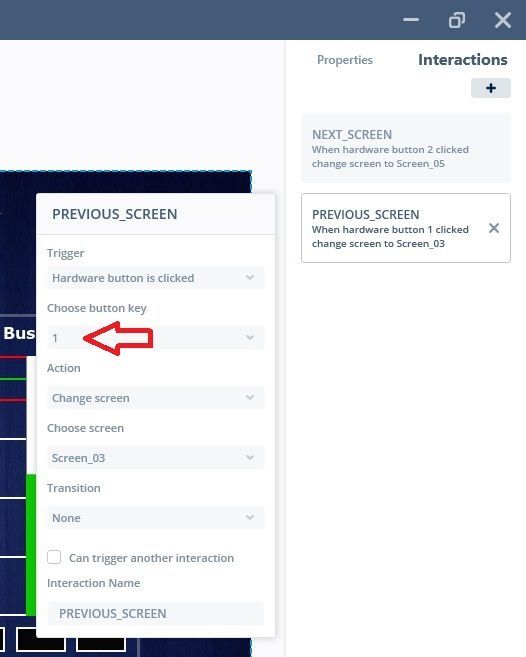

For PREVIOUS_SCREEN Interaction , below is example

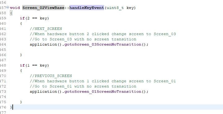

for each ScreenViewBase.cpp , the transition will be added like below

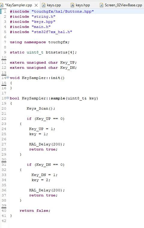

Now , need to code the keys read feature any one of followings
1. Simple GPIO keys without interrupt
2. SPI IO Expander Keys with interrupt
3. I2C IO Expander Keys with interrupt

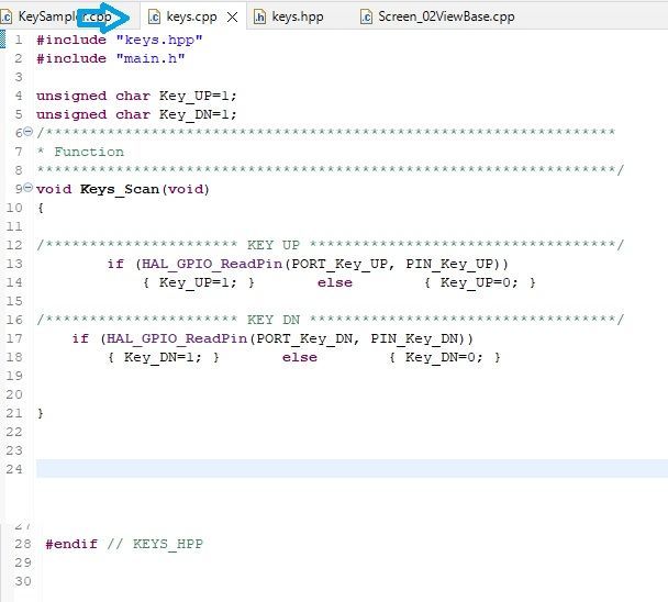

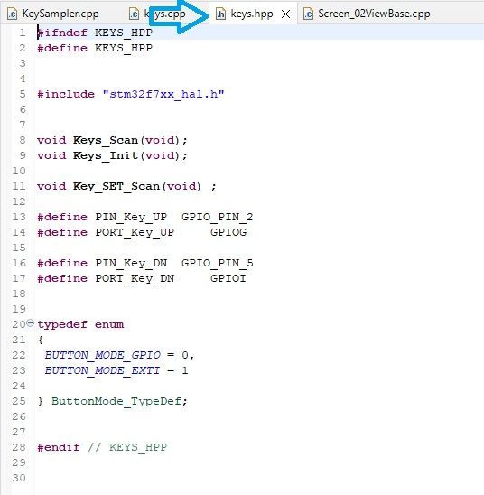

I will show you 1 example > Simple GPIO keys without interrupt
keys.hpp
keys.cpp
Don't hesitate if more info required , Just Ping me ... 8)8)
