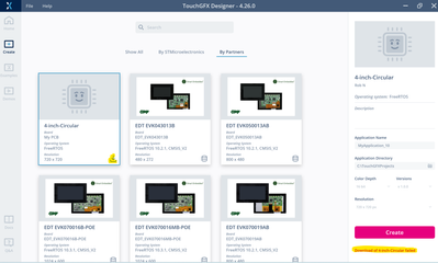

I created a TBS following the instructions here https://support.touchgfx.com/docs/development/scenarios/scenarios-create-at
I'm using TouchGFX V 4.26.0 so I altered the instructions given for V.4.25.0 accordingly.
Apart from some confusion over the naming of the JSON file which always reverts to 'MyApplication' following the pack command, the TBS that I created worked.
I then went on to create a second TBS for a different set up. However this one didn't work, and the first TBS that I had created stopped working. (I must add at this stage that I don't recall changing anything that related to the first TBS when I created the second but I honestly can't be sure).
The error I get is 'Download of 'MyAppicationName' failed, this is shown highlighted in the screenshot below at the bottom right. My two TBS's are highlighted with red star. The first TBS I created is named '4-inch-Circular', and the second 3.45 inch starter project.
I think when I created and tested the first TBS, the download icon (down arrow in the bottom right of the TBS icon in the snip) showed as 'available offline', but I can't be sure of this.
.... So that raises the question, where is the TBS expected to be downloaded from as surely its' stored locally in the .tpa file that I created and placed in location C:\TouchGFX\4.26.0\app\packages ?

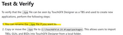

2025-11-14 2:13 AM - edited 2025-11-14 2:21 AM
I went on to change the name of the .tpa file (as the documentation says you can). After doing so the TBS failed to work, previously the TBS showed as being available offline but now shows that it is available for download and gives a Download error when the Create button is pressed.
I now believe this explains my original issue.

Hello @RobNewbury ,
Thank you for your post, I will try to investigate that. The point 1 seems to be a bug to me, tgfx.exe pack -d should create your tpa with the provided name. For point 2, I would recommend not to rename manually, but I agree with you that it shouldn't behave in a strange way if renamed. For point 3, we will consider to document it better if its needed.
