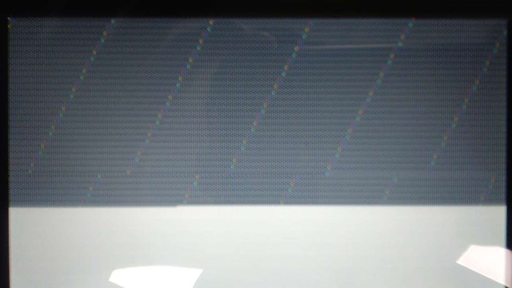

At this moment I have this:
This image should show colors bar (a function from video decoder) and we can see a few pixels like it should be.
I'm checking DCMI settings and synchronization. If I move camera position this screen has little changes, but with this beautiful pixels!
Thanks
2019-09-02 4:54 AM
How are you doing on this? Did your checks turn up anything? How many bars did you expect there to be? There may be an offset issue - That's typically indicated by the slanted lines. Maybe your dynamic bitmap is one pixel too wide.

Hi Martin,
Well about the bars the problem was the synchronization in HSYNC, because I was expecting that DCMI peripheral should do this, but it doesn't.
My camera format is YCbCr, so I needed to implement in code this sync and then convert, in code too, to RGB888 format.
The problem about this is the frame rate, which I could reach only 10 FPS (because the conversion YCbCr > RGB888 done in code).
In TGFX side, I add a Dynamic Bitmap and every VSYNC interrupt I do the conversion and invalidate the image.
Another think is that the camera has more resolution than my TFT, so currently I show only a part of full image, because I think if I downscale I need more processing and could reduce even more the FPS.
Regards
