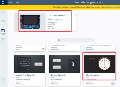

2024-10-07 7:43 AM
I use this combination
2024-10-07 8:01 AM
