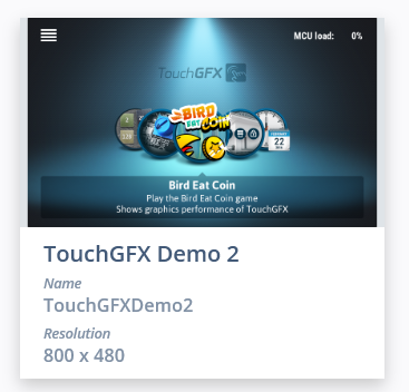

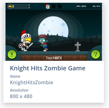

2021-08-23 7:25 PM
Thanks!
IDE: TouchGFX Designer directly.
The demo Knight Hits Zombie Game is OK.
Build the demo TouchGFX Demo2 failed.
Does the TouchGFX IDE 4.17.0 not support SPI Flash? (I built the Demo2 using 4.16.x and run on 747-Disco board successful.) The TouchGFX Demo2 needs external SPI Flash.
2021-08-23 7:57 PM
Hello Ltony.1,
I don't have the H747 board with me but I can still compile and I have no problem.
I see a difference between the default config and your config. Did you change something ?
/Alexandre
