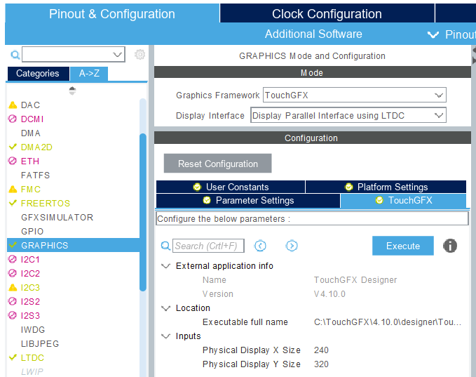

I have had problems to integrate TouchGfx (4.10.0) in CubeMX (5.2.1) & Keil (5.25.2), I have followed all the steps in detail that are on your page, following the steps for this purpose and the button EXE is not enabled. What should I do? Is there another way to integrate the 3 tools?

Hi @Miguel Moran,
I need some additional information. did you install Touchgfx 4.10.0 and point CubeMX to the designer executable? Did you "generate code" at least once? (Otherwise the .touchgfx project file won't be generated and the designer can't open anything).

I have already installed the cubeMX software and I have used it with Stemwin for some time now, without any problem, I always keep the CubeMX & Keil updated. I have installed Touchgfx, from the CubeMx pack folder, I have carefully followed the configuration instructions, which are suggested on your page and I have compiled the project at least once as indicated.

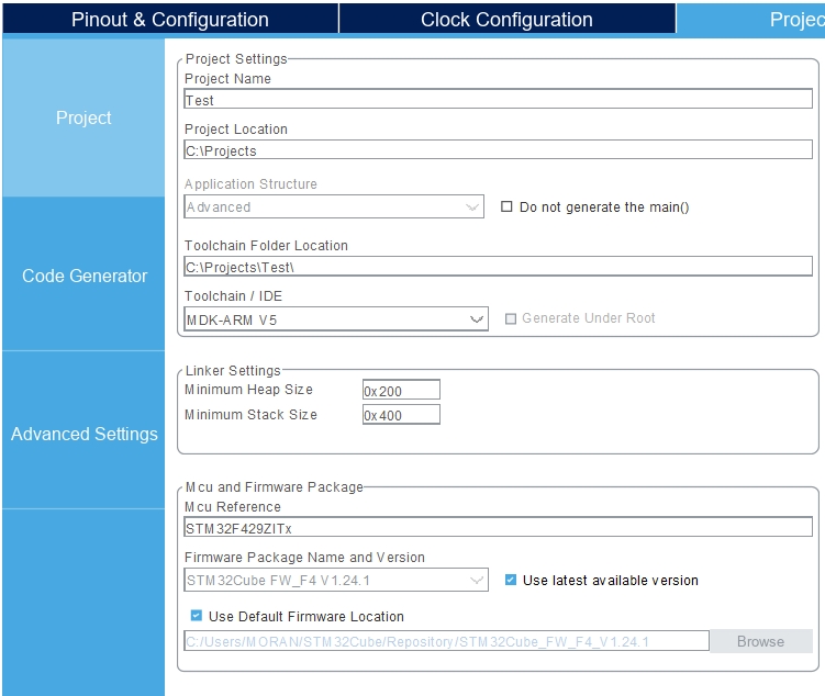

Hello again, I want to share with you, where the problem is and how I solved it. Observing carefully the page where the steps of the configuration with the cubeMX are narrated in https://touchgfx.zendesk.com/hc/en-us/articles/360021620431-Configuring-STM32F429I-DISCO
and comparing each of the boxes, I noticed the following:
in the "Project Location" box, in "Project Manager", I originally had a fairly long route and I shortened it by placing "C: \ Projects", I attached a couple of screenshots to verify the fact, and I hope this can help others with similar problems ........ I thank you in advance for the help provided so quickly.

So you're saying that the long project location path prevented you from "executing" Touchgfx? I'll look into this, thanks.

"So, are you saying that the long route of the project location prevented you from" running "Touchgfx? I will investigate this, thank you."
That's right.!!
