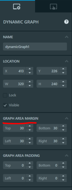

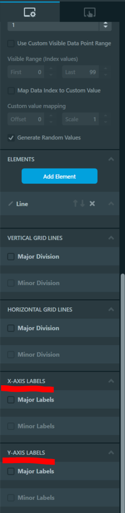

Could you share a screenshot of your graph configuration in TouchGFX Designer ? In the right tab there is an option to set the text for the label, you also have to set the "Graph area margin" section.

2021-02-12 2:43 AM
/Romain

2021-02-15 12:46 AM
Hi Romain,
Thanks for sharing those details, now I'm able to see the y-axis labels on the UI.
I'm trying now to update the graph with sensor values.
/Megh
