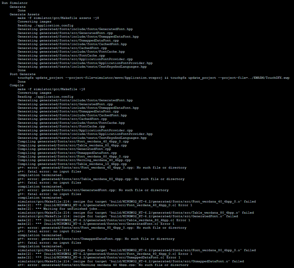

I have met the same issue regarding "cannot find certain fonts cpp" with TouchGFX 4.16.
I just followed the official tutorial 2 step by step.
The error occurs after adding the range "0-9" in the "Wildcard Ranges" column for the Default typography.
Compiling generated/fonts/src/Table_verdana_10_4bpp.cpp
g++: error: generated/fonts/src/Font_verdana_40_4bpp_0.cpp: No such file or directory
g++: fatal error: no input files
compilation terminated.
g++: error: generated/fonts/src/Table_verdana_80_4bpp.cpp: No such file or directory
g++: error: generated/fonts/src/GeneratedFont.cpp: No such file or directory
I checked the files under generated/fonts/src/ dictionary, all above mentioned files exist.
I did the same tutorial 2 with TouchGFX 4.15, it works fine.
I also compared generated files from two different TouchGFX Designer, they are identical.

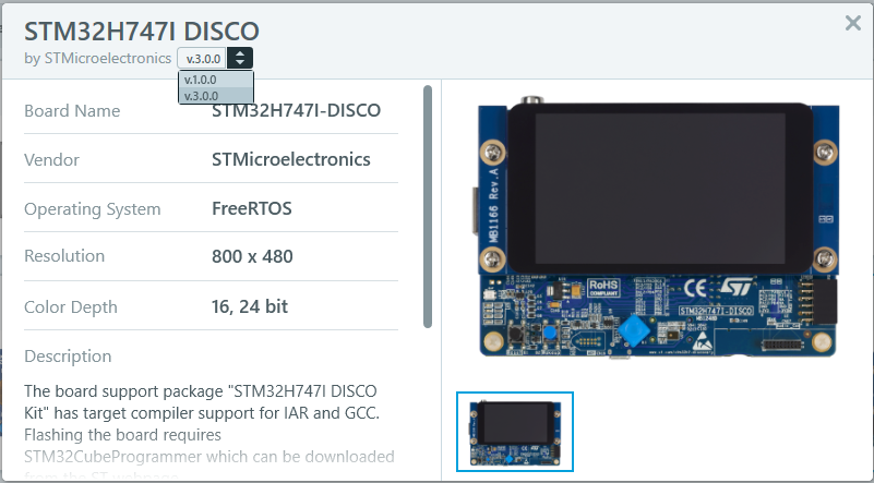

The application templates for the H747 boards are a bit apart from the others because the ATs are quite old now and are not based on STM32CubeMX (because CubeMX does not support dual cores and additional softwares). I have reported the issue but I) can only advise to continue using 4.15 until this is fixed. (maybe look at the makefile in the gcc folder to see the call for those files)

And again I tried to switch the application template version to v1.0.0 (default version in TouchGFX 4.15.0) with TouchGFX 4.16.0, but it failed again.
Now I will continue using 4.15 until someone fix this bug.:>
