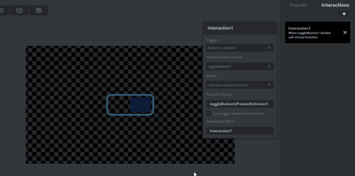

Basically, what you have to do is to fetch the action (this can be done by using an interaction calling a new virtual function in your screen :
This way, a virtual function is called whenever you click that toggle button.
You then have to implement that function in your screen1view.hpp and screen1view.cpp and you have to propagate the notification to the model (screen1view.ccp => screen1presenter.cpp => model.cpp).

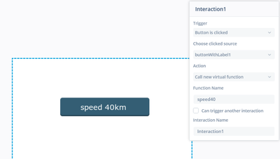

Hello, what I mean about the toggle button is that when I press the button for the " speed40 km" , it triggers a virtual function called 'speed40'. In this function, I want to send this data frame to a display of car So, I'm unsure whether I should configure the filter, transmit header, and add message in the main.c file or in the Screen1View.cpp file.
