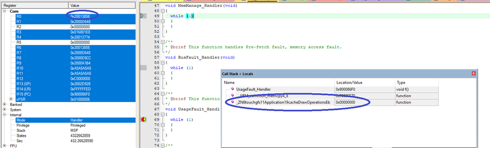

i have a problem with TouchGFX. After filling the framebuffer via DMA2D (DMA2D class of TouchGFX) i got a Usage Fault "unaligned". Last called function was __ARM_common_memcpy4_8 in touchgfx lib. When i have a look at the register values the register R0 has a not 4 byte aligned adress. Further the adress referenced to member variable "lastRects" (type vector template class) of Application class (member of FrontendHeap). Using the ARM "__((aligned (4)))" doesn't fix this problem. Further I don't know where exactly the instance is declared? Is it really because of the unaligned adress? How can I solve the problem?

Which MCU? You may need to protect your framebuffer memory region with MPU to not get unaligned errors.

I'm working on STM32F750Z8 with external Flash (via QuadSpi) and external SDRAM for frambuffer. The lcd display is RGB interface type controlled by LTDC of microcontroller. The MPU is already defined. More precisely, it is protected over the entire SDRAM (in my case 0xC0000000 until 8MB size).
I really don't know what could be wrong.
Is the "__ARM_common_memcpy4_8" function a own TouchGFX function? Not like standard "memcpy" function?
I tried to overload "memcpy" to find out when it breaks down. Unfortunatelly "memcpy" won't be called.
