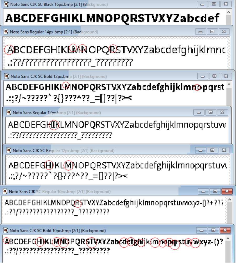

Many TouchGFX generated font bitmaps contain pixel errors (understandable)
What is the recommended way to manually fix these pixels into correct location?

I have a similar problem on a 1bpp screen. Some strokes on characters seem to round up to 2 pixels, others down to 1 pixels. So the vertical line in E, I, L and T etc is 2 px and the horizontal line is 1 px.

I was able to correct 1bpp fonts with FontForge. No luck with 2bpp fonts with this method (they end up scrambled).

Is there a solution to make characters on a 1 bpp screen less blocky (see annotated screenshot)?
