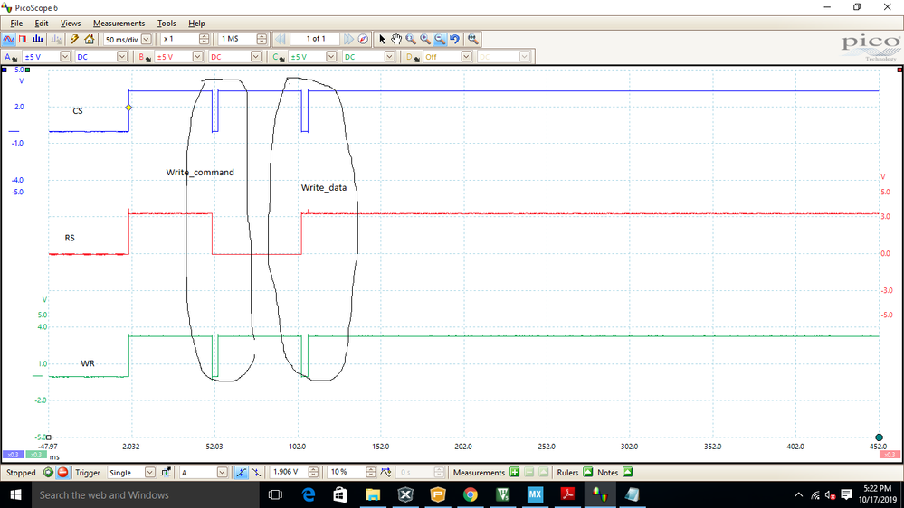

Initially All controll pin high for 50ms then Write_Command(); delay 50ms Write_data();
please see the attachement.

which trace is which ?
where is the nCS pin ? RST pin ? RS pin?
you need to see all the pins...
are you sure the data pins are doing what you expect ?
You will see the issues on the scope...
I hope you have secure hook up wires and not lose connections, did you solder them in place ?
Check the power rail is correct too, did you add a capacitor on the display side of the power wires ?
a solid ground wire is necessary, a thicker wire is always a good starting point for ground.
good luck.
i checked the level of data pin, and it is according to the data. i have reset the display at the starting of main function.
TFT proto 5" is adisplay module with SSD1963 inbult controller, it has D[0-15], cs, RD, WR,RST, TE, RS pin 3.3V and GND pin for external connection with the controller.0690X00000AqWg3QAF.png
T J
Lead
those pins look good
You have to check the other pins and the startup code.
Is reset High active or low active ?
the backlight is separate from the LCD data usually,
so you should see some light somewhere,
otherwise shine a bright light on it, you have an image but no backlight.
good luck, you need to do your own discovery, if it was easy everyone would be doing it.
check your ground wire is thick, and your power is clean..
good luck.. keep working on it...
T J
Lead
I cant do your work for you... , but I can see this looks wrong,
line 47
HAL_GPIO_WritePin(GPIOC, GPIO_RST_Pin|GPIO_CS_Pin|GPIO_RS_Pin|GPIO_RD_Pin
|GPIO_WR_Pin, GPIO_PIN_RESET);
all those pins should be high on startup GPIO_PIN_SET !
in Main after the pins are initialised , wait 1mS , pull Rst# low, wait 1mS , then RST# High for a proper reset.
you need capacitance on the power cable, just 47uF or something, I cant imagine your wiring issues...
take a photo and show us...
