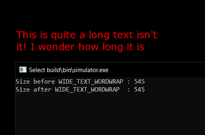

Hello @Hafsa and welcome to the community!
I am not sure I understand what you want to achieve.
I have created a textArea, set its width manually to 300 and wrote a text longer than 300 pixels, I have also put the textArea behavior to "wrap between words".
I run this function when clicking the button :
virtual void function1()
touchgfx_printf("Size before WIDE_TEXT_WORDWRAP : %d\n", textArea1.getTextWidth());
textArea1.setWideTextAction(WIDE_TEXT_WORDWRAP);
touchgfx_printf("Size after WIDE_TEXT_WORDWRAP : %d\n", textArea1.getTextWidth());
And I get this result :
So with or without WIDE_TEXT_WORDMAP, the result is the length of the text, not the length of the textArea.
Perhaps you can share your project so I can see what you have done!

2025-03-20 6:34 AM - edited 2025-03-20 6:39 AM
Regards,

2025-03-24 2:51 AM
Hello @Hafsa ,
getTextWidth returns the width of the text in the current language :
If you want to know the longest width of the textArea in all languages you should loop through all the available languages at startup and store all the widths.
You can change the language by code with Texts::setLanguage(YOURLANGUAGE);.
Make sure to include <texts/TextKeysAndLanguages.hpp>.
