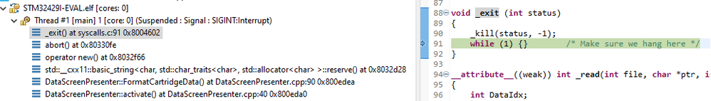

My issue is that the application is crashing (jumping to the syscalls _exit function) when I use C++ strings in the IDE build but not the build generated by the TGX environment using the gcc makefile.
In my application I am using C++ string variables in a presenter to create formatted content to use when updating the view.  What I observe under the IDE debugger is that the strings have an initial allocation of 16 bytes. If I exceed this when I build a string or if I try to manipulate the allocated size, the application crashes. This does not happen with the build generated in the TGX environment - the dynamic allocation occurs as expected.
Below is a screenshot of a code sample and the variable values. This is a simplified version of what the code does. The reserve operation is not a part of my normal application - it is just there for testing.
I am not seeing the RTOS task stack overflow hook being called. I also tried using the TGX linker file with the IDE build and the crash still occurs.

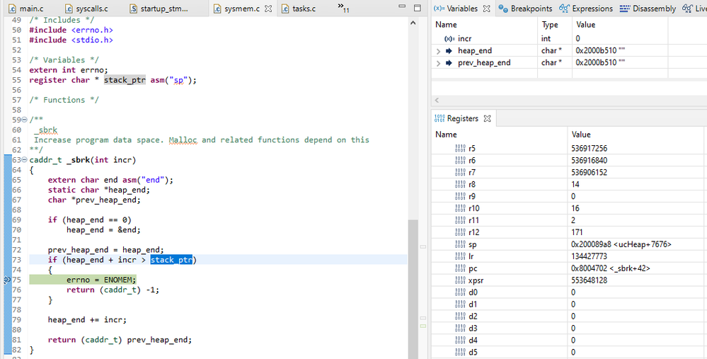

I have a workaround but not really an understanding as to why it works.....
The issue turns out to be the implementation of the _sbrk function. The call to _sbrk function to malloc more space for the string was triggering the ENOMEM error. Surprisingly if I comment out the function, the application compiles and uses the sbrk function native to the compiler.
