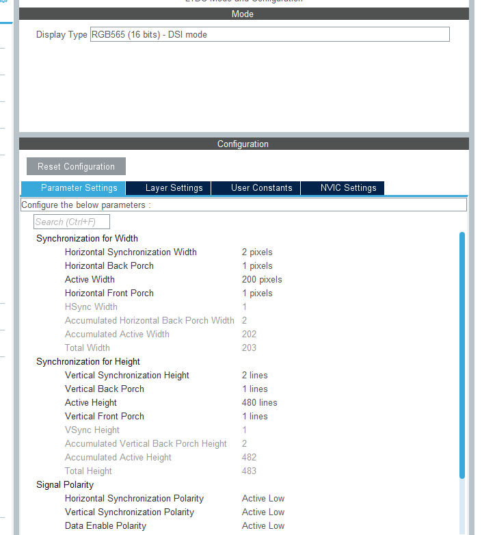

I receive yesterday the board from Mouser. After powering up I notice that the display did not start with the usual demo as my other new STM boards starts. Then I try to load it from TouchGFX app but still the screen was completely black. I try with separate simple "blink" project and everything was normal. I'm not sure for this board, but i believe that in the moment of powering up the display's back light should blink for moment. Correct me if I'm wrong because this display do not blink.The other think that I notice is that the code that is generated from TouchGFX is suspicious - see attached photo. The resolution of the display is 800x480 according to the datasheet. I'm not sure that it matters but my board is with blue solder mask.

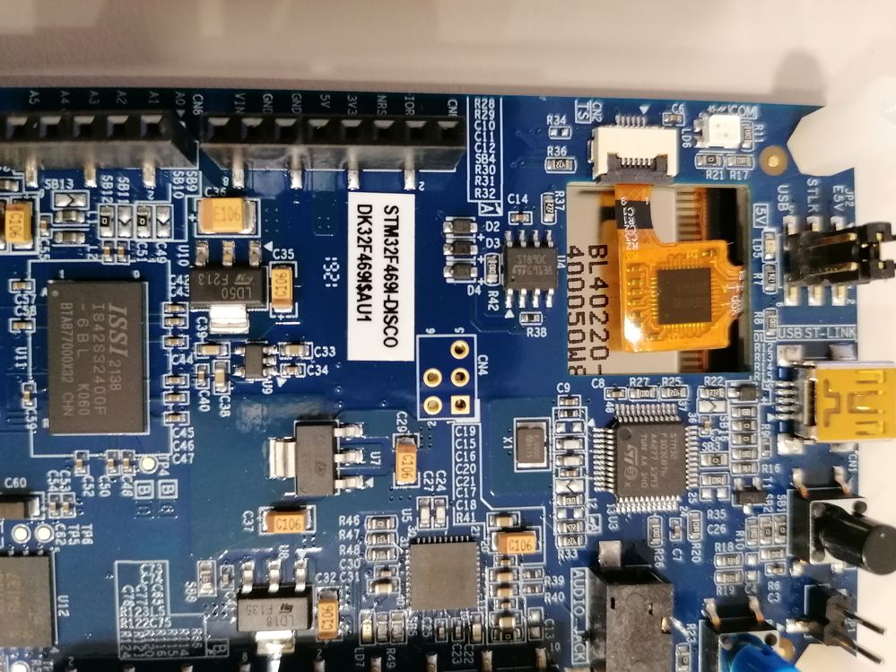

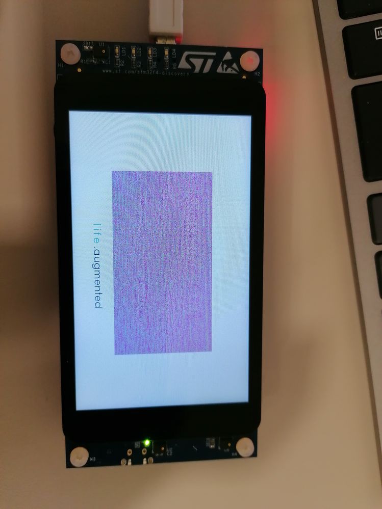

Thank you for the replays! I found that the problem is not in the HW part. With the official binaries the display at least give some signs of live. From what I understand till now the different revisions had a different displays, touch controllers etc. I am little disappointed but I hope that soon there will be software solution for this issue. I made some photos of the board just for reference. MB1189-F469NIH6-B08 A222300851

I saw that you have the same revision as mine. With your binary the result was again dark screen. What model is your display?
2022-12-02 1:07 AM
Ok, strange also tried to reupload the elf file on my Discovery and now it does not work..
But when I open the TouchGFX project (B08 branch) and click on Run Target it still works.
