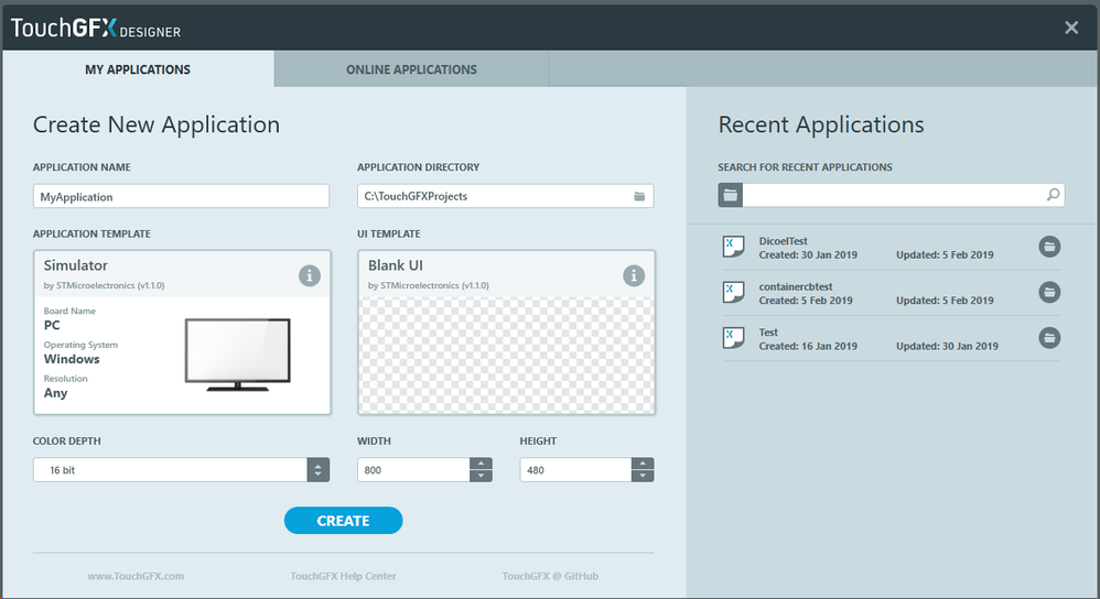

Hmmm no. Where can I encounter it?
2019-02-07 12:21 AM
You can find it in the examples tab when creating a new application through the TouchGFX Designer.
2019-02-07 12:59 AM
I'd given it a look before asking ofc and couldn't see it. Thought I was blind. But I definitely don't have the said tab.
2019-02-07 12:38 PM
Hi @GMeur.
Pardon me for not being more specific. Press the "Blank ui" UI template to select a different one. You should then gain access to examples and demos.
Best regards,
Martin
