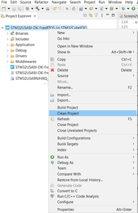

When I have this issue, I try to right-click on my project on STM32CubeIDE and "clean project", it helps sometimes.

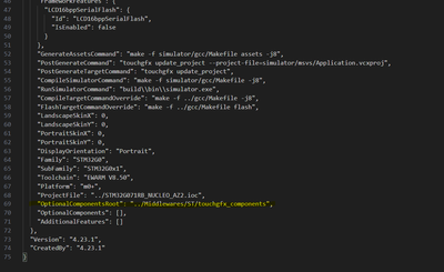

Could you check if in your .touchgfx file you have this line?
"OptionalComponentsRoot": "../Middlewares/ST/touchgfx_components"

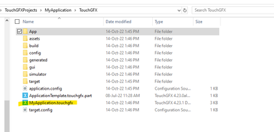

The .touchghfx file is your TouchGFX project file which is generated when you create a project.
If you open it with a text editor, you should have the "OptionalComponentsRoot" line :
Could you check that?

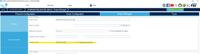

Also, could you try generate code not from STM32CubeIDE but STM32CubeMX instead (and generate code on TouchGFX Designer afterwards)?
