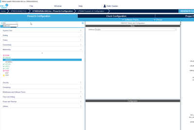

Hello @bytespectrum ,
It should be possible to use only one lane but you have to make sure you get enough bandwidth.
You say that you changed lane in STM32CubeMX but if I look for DSI on the provided STM32U5G9J-DK1, it seems to be deactivated:
Can you run me through the steps you took to activate one lane?

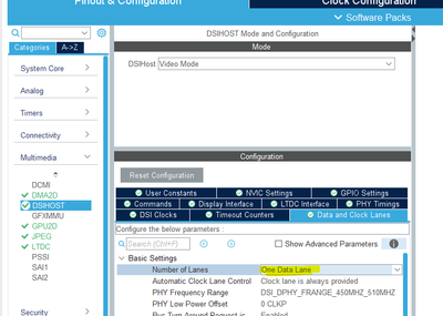

2024-09-10 2:31 AM
Hi Gaetan,
Thanks for prompt response. Bandwidth is not a problem as of now for us.
I am using TouchGFX Designer to generate my firmware for STM32U5G9J-DK1 board.
I have attached my firmware which is working good with 2 lanes in same board.
As highlighted in below screen shot, I am changing data lines to one but it is not working.
Thanks,
Tarun
2024-09-10 8:44 AM - edited 2024-09-10 8:47 AM
@bytespectrum wrote: Bandwidth is not a problem as of now for us.
That is a great thing.
I have looked at your project.
When changing to one lane, the value is correctly changed from DSI_TWO_LANE to DSI_ONE_LANE in main.c at line 434 :
hdsi.Init.NumberOfLanes = DSI_ONE_DATA_LANE;

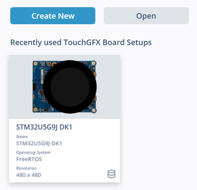

Immediate problem that I noticed is, you are selecting wrong board. Please select STM32U5G9J-DK1 instead of STM32U5G9J-DK.
I used below board.
I am looking at why you are not able to compile my project.

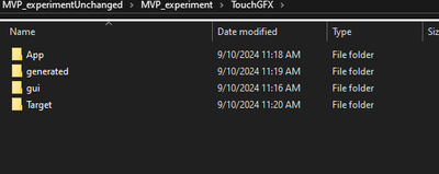

When I unzip your file, the TouchGFX folder is missing files:
So I open the ioc file and generate code.
Back to the TouchGFX folder, I open the Application.Template.touchgfx.par file, this creates the STM32U5G9J-DK1.touchgfx file. I open this last one and click on Simulate (since the flash button is greyed out) and get this log :

2024-09-11 1:34 AM
Hi Gaetan,
Code is well compiling from STM32CubeIDE. I deleted simulator related files from TouchGFX file to minimize file size. I have attached TouchGFX folder which has all files. Just replaced folder in previous file I shared.
