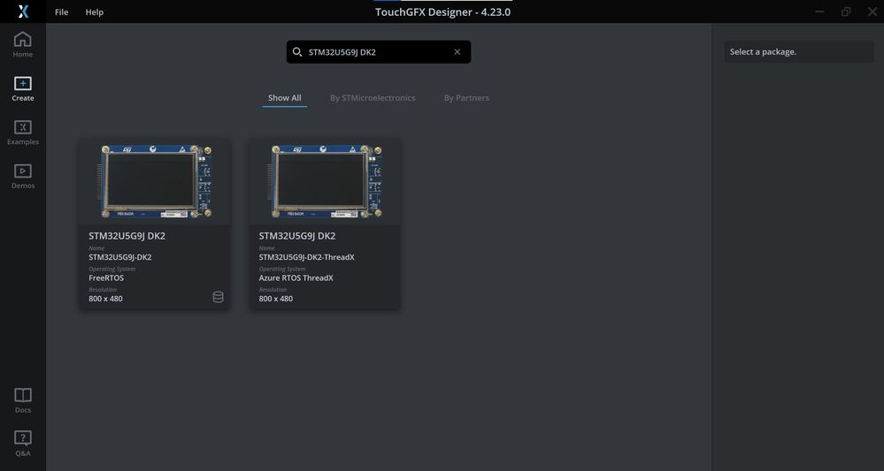

We will publish a board setup for DK1 in the coming weeks, but if you are short on time, you can take a look at the available board setup for STM32U5G9J-DK2 on TouchGFX.
I hope this helps

Yes, they do. Both will have NeoChrom graphic accelerator which helps a lot with vector renderings. And, this feature is enabled on the STM32U5G9J-DK2 available on TouchGFX.
STM32U5G9J DK2 Board SetupSTM32U5G9J DK2 Board Setup
You can read more about vector rendering here
