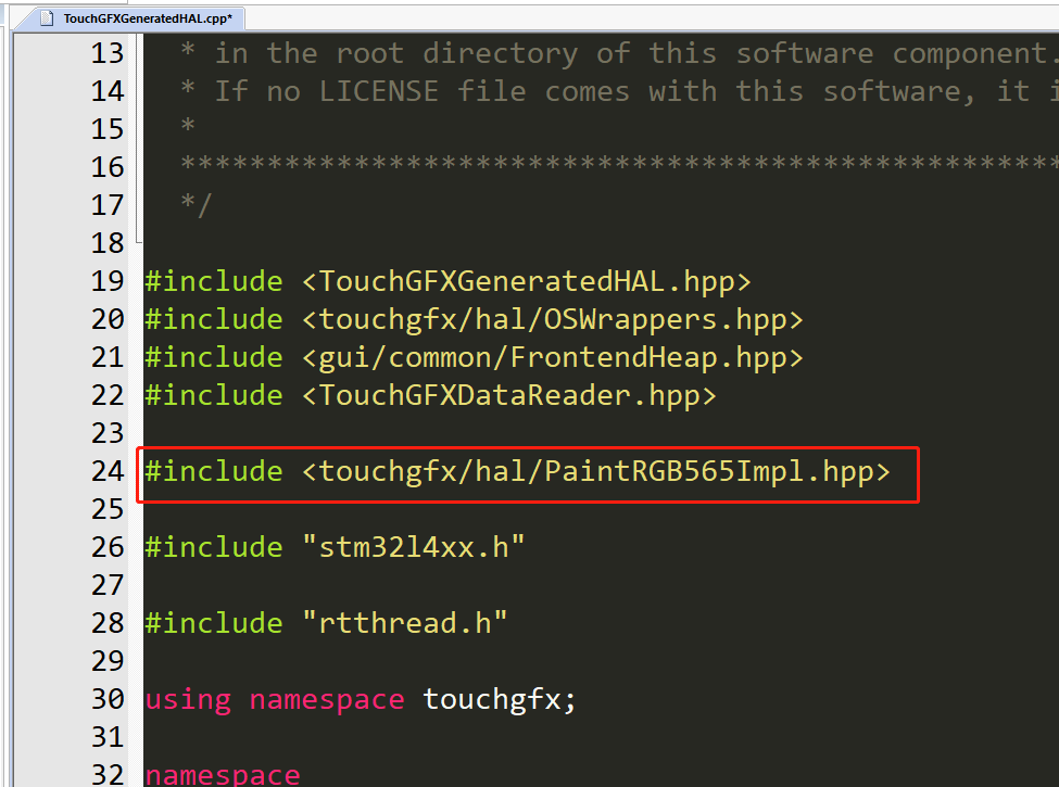

2022-06-30 3:23 AM
add the blow header,the error disappear

I've got similar errors while upgrading from 4.19.1:
Error: L6218E: Undefined symbol touchgfx::paint::rgb888::lineFromColor(unsigned char*, unsigned int, unsigned int, unsigned char) (referred from painterrgb888.o).
Error: L6218E: Undefined symbol touchgfx::paint::rgb888::tearDown() (referred from painterrgb888.o).
Error: L6218E: Undefined symbol touchgfx::paint::rgb888::lineFromRGB888(unsigned char*, unsigned char const*, unsigned int, unsigned char) (referred from painterrgb888bitmap.o).
Error: L6218E: Undefined symbol touchgfx::paint::rgb888::lineFromARGB8888(unsigned char*, unsigned int const*, unsigned int, unsigned char) (referred from painterrgb888bitmap.o).
Error: L6218E: Undefined symbol touchgfx::paint::rgb888::lineFromL8RGB888(unsigned char*, unsigned char const*, unsigned int, unsigned char) (referred from painterrgb888l8bitmap.o).
Error: L6218E: Undefined symbol touchgfx::paint::rgb888::lineFromL8ARGB8888(unsigned char*, unsigned char const*, unsigned int, unsigned char) (referred from painterrgb888l8bitmap.o).
Error: L6218E: Undefined symbol touchgfx::paint::rgb888::setL8Pallette(unsigned char const*) (referred from painterrgb888l8bitmap.o).Including PaintRGB565Impl.hpp, as shown above did not solve an issue - error messages changed to "multple defined symbol" for all those methods.
