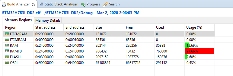

2020-03-03 1:35 AM
Is there anything like stack pointer, heap, RTOS related something in the RAMFB area, possibly overlapping the frame buffer?
