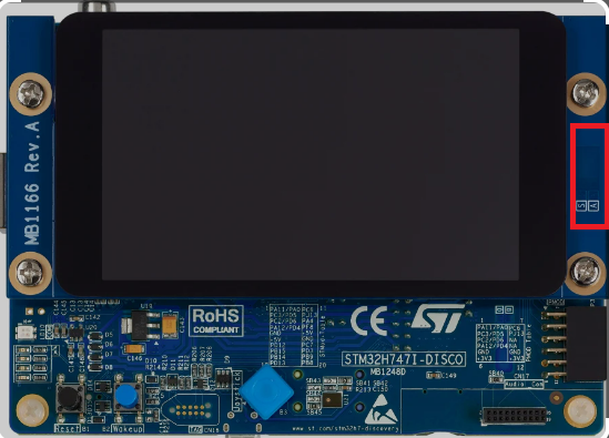

Which MB1166 Rev.A revision are you Using? A01, A03...?
You can find the MB1166 revision as shown in the below figure.
Thank you,
Kaouthar
2023-04-18 2:05 AM
The MB1166 is revision A03
