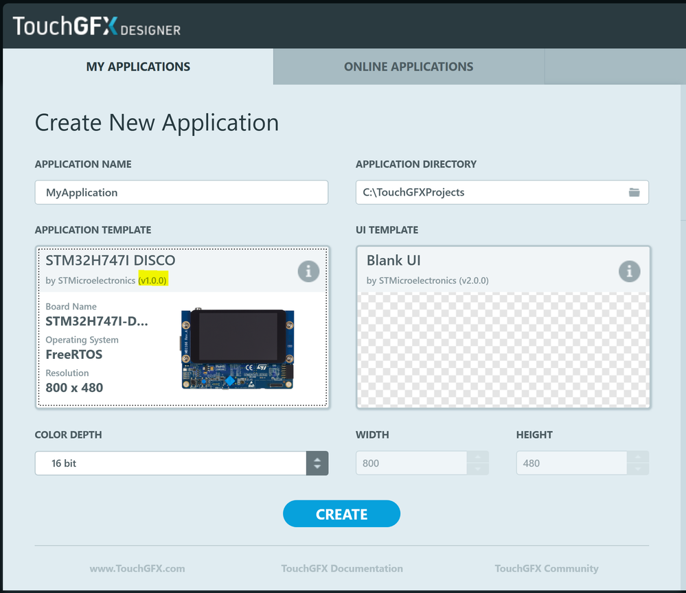

If you look closely when choosing an Application Template you can see a version. For H747-DISCO, the version is 1.0.0 as you can see highlighted on the picture below.
For an Application Template to be with an .ioc file, meaning to be compatible with TouchGFX Generator inside CubeMX, this version must be superior or equal to 3.0.0. Therefore, it is normal that a version 1.0.0 has no .ioc file.
The reason why there is no 3.0.0 version for the H747 is because CubeMX does not yet support the dual core of this MCU, therefore it is not possible to configure it in CubeMX. I do not know the schedule for this CubeMX update but it is to be done in the foreseeable future.
