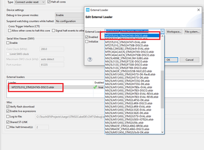

I reproduced the behavior and seems you didn't select the correct External Flashloader:
The correct one is: MT25TL01G_STM32H745I-DISCO.stldr
I was able to upload the external QSPI after setting correct flash loader.
Hope it does answer your question.

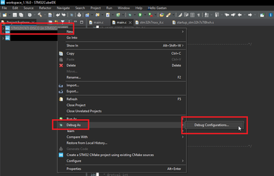

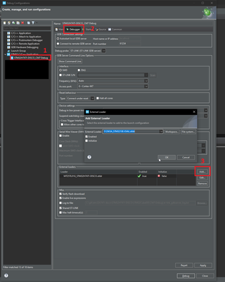

Hello @Maximiliano ,
It seems you have not mentioned the file to use as external loader.
This can be easily fixed.
This should fix your problem.

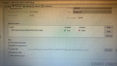

I had tried what you mentioned but it doesn't seem to work, I don't know if you meant that the file is inside the project folder. I selected the one that seemed right for my model from the options that the compiler gives me, it looks like this:
but it throws the same error.
