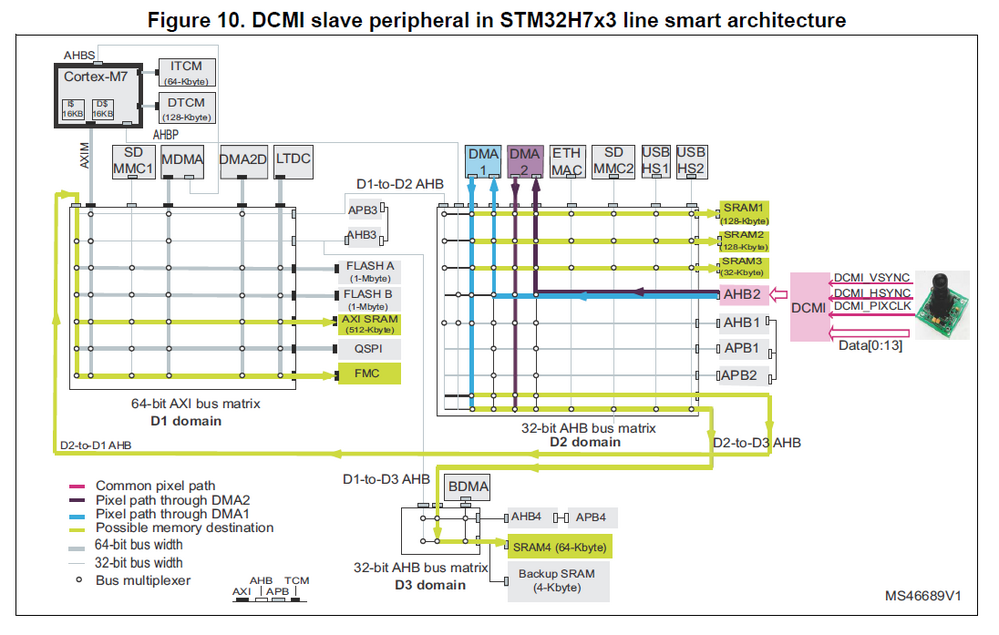

I have STM32H753 which in AN5020 has architecture like this:
(Application note, Digital camera interface (DCMI) for STM32 MCUs)
So it has connection between DCMI and FMC via DMA1/2 and D2-D1-bridge.

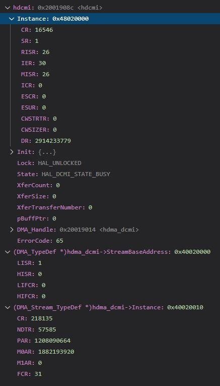

When HAL_DCMI_IRQHandler triggered I got:
So for DCMI I have in MISR register DCMI_FLAG_OVRRI = 0x02 and for DMA in LISR register DMA DMA_LISR_FEIF0 = 0x01.
FIFO treshold DMA_FIFO_THRESHOLD_HALFFULL without burst DMA_MBURST_SINGLE no effect.
