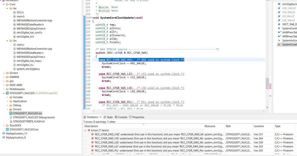

2021-03-24 2:19 PM
modified the system_stm32g0xxx.c file according to this thread: https://community.st.com/s/question/0D53W00000OUZHcSAP/stm32cubefwg0v140-bug-
Manage to build succesfully... however-- stil white background (also when running from touchgfx).
