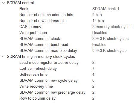

I am using MT48LCM16A2TG SDRAM. Here is CubeMX timing values;
I checked values from datasheet. But i dont know why did happing.
So, if it is about sdram configuration, Why no problem occurs when i clear sdram?
