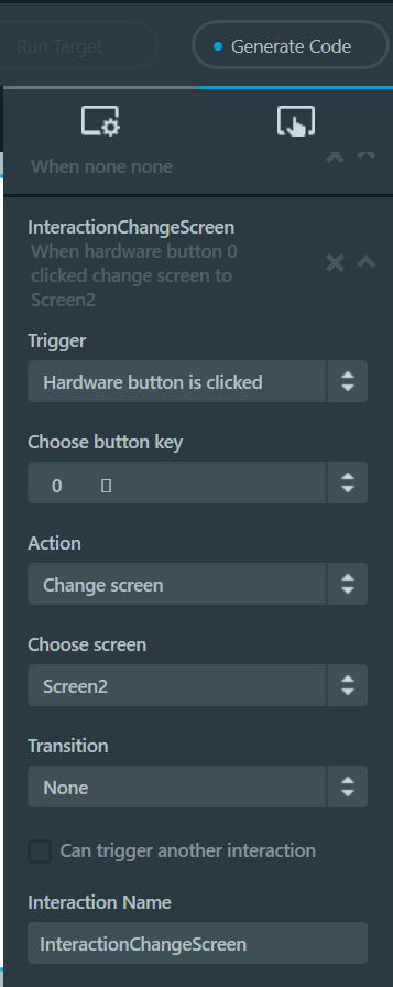

I would advise to create an Interaction within TouchGFX Designer where you set as Trigger "Hardware button is clicked" (a dummy button that you will not set) and as Action "Change screen". With this will be generated in <nameOfScreen>ViewBase.cpp a function called application().gotoScreen2ScreenNoTransition(). It will have a different name if you use another transition or have another name for screens. You can then call this function in your <nameOfScreen>View.cpp when the counter reaches 0.

I'm a bit confused by what you tried to do and the flex button.
What I had in mind was just to have a fake hardware button and interaction, and then add in screenCurrentView.cpp the following function where you check all the time if the conditions are met or not to then call the changing screen function
void ScreenCurrentView::handleTickEvent()
if(!min_current && !sec_current)
application().gotoScreenSetScreenNoTransition();
