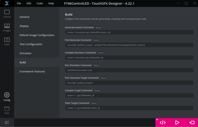

Hello @Tesla DeLorean ,
May I have more information about the build options? The following is the screenshot of the build options in my TouchGfx.
It would be better to have a working demo project, even if it is a single touchable button on the screen.
