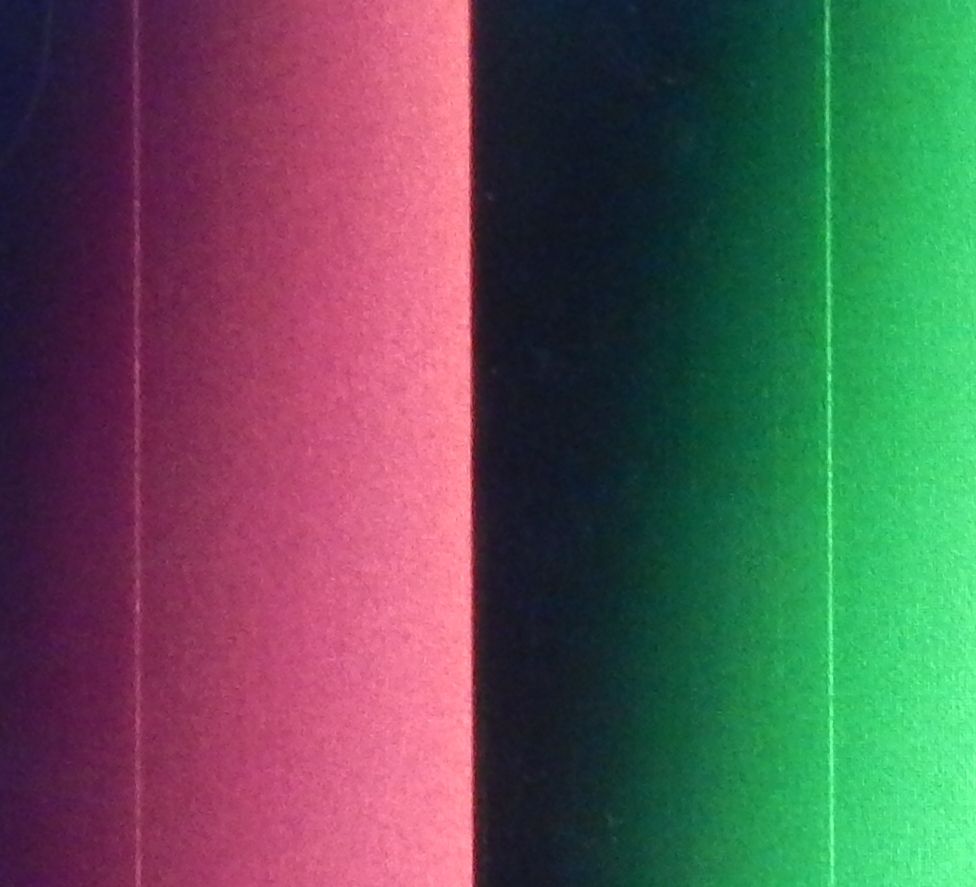

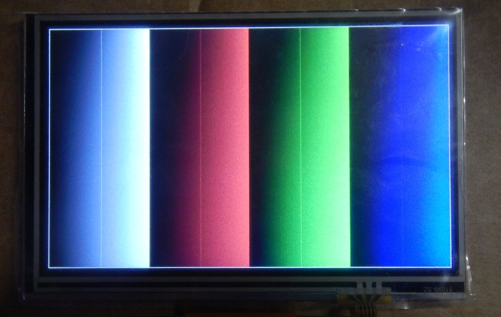

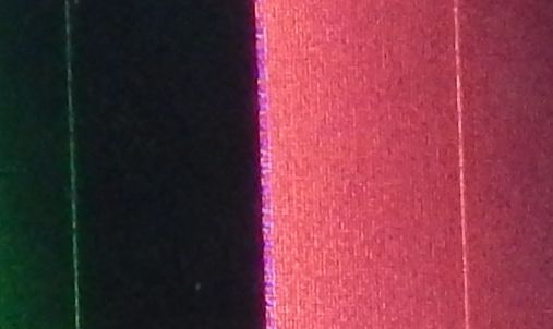

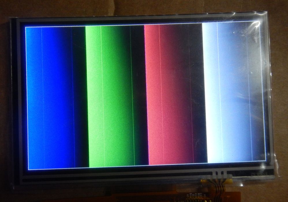

Posted on April 03, 2017 at 21:26
brightness decreasing: two glitches, i guess one on 3/4 and another at 1/4 brightness; and one particular red channel glitching;
whole screen, you see those vertical glitches are on same positions for all 3 color channels
brightness increasing: one glitch exactly at 1/2 brightness
whole screen

Posted on April 03, 2017 at 23:45
well, huh, those nasty electrons... MCU, LCD and my code are proven to be innocent!
I've changed all ceramics around LCD pins and memory bus and voila, magical dissapearance of bus glitches - they all are gone.

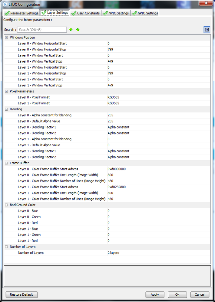

the config of LTDC and Layers, we are discussing TFT display problems. I attached my layer settings for 800x480.
