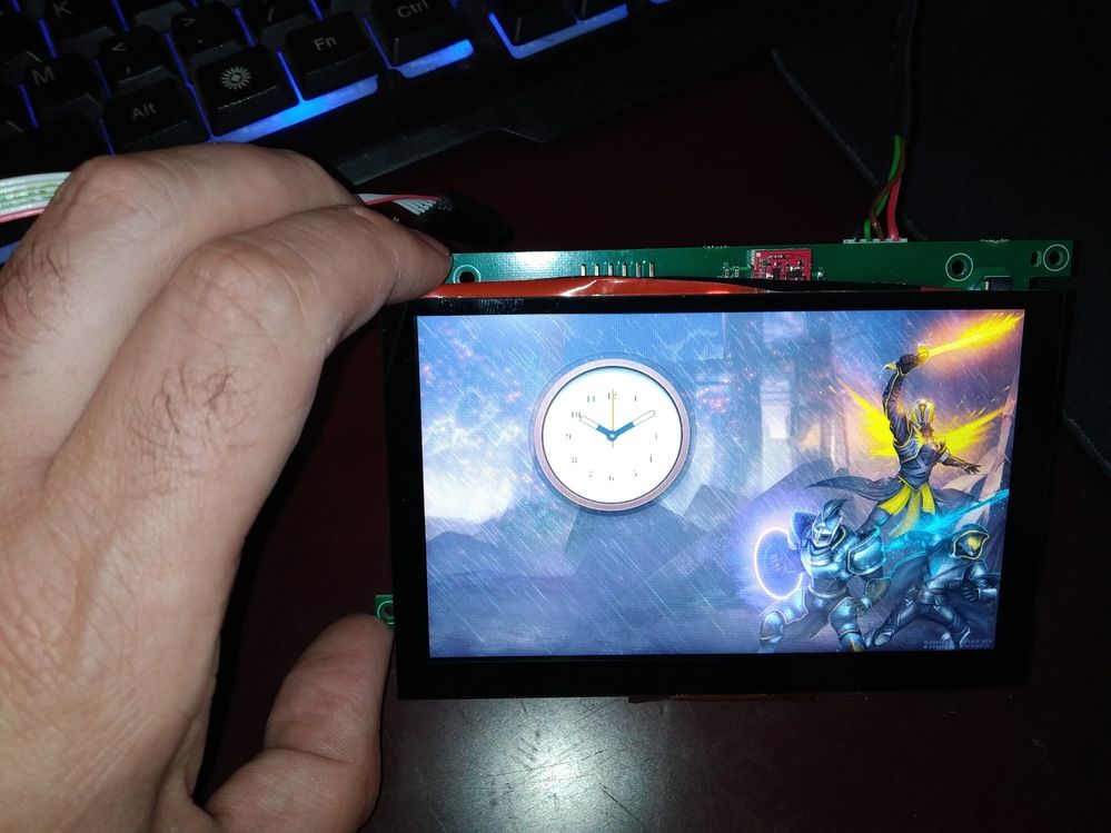

The TFT on my board displays:
I am not sure about the LTDC parameters based on the new TFT. I have set the below:

Thank you for your answers.
I fixed the parameters but still problem. Then i changed the Pixel format to:
pLayerCfg.PixelFormat = LTDC_PIXEL_FORMAT_RGB565;
And it worked.

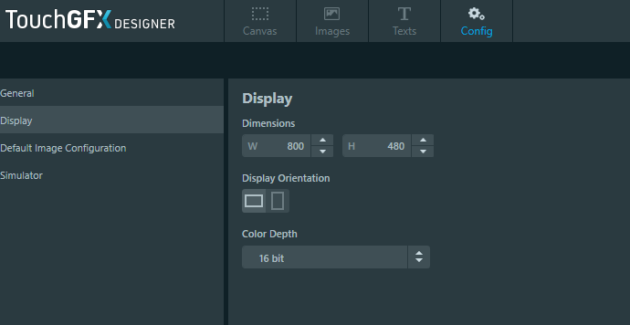

On TouchGFX project the Pixel format is "locked" to 16bit. Is there a way to change it to 24bit or i should create new TouchGFX project?
2020-05-23 2:43 AM
Hi
Just Create new Touchgfx project and then try...

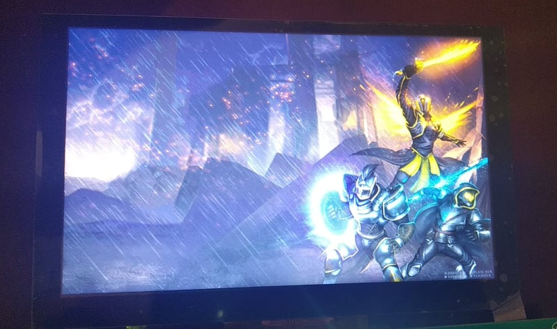

That does look a lot better...
2020-05-23 7:31 AM
Worked with RGB888 setup too, thank you guys.
