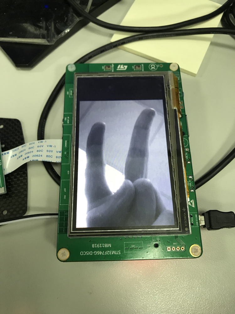

Recently I've developed a graphical application on the STM32F746G discovery board. It displays gray-scale frames (400x400/8bpp/120Hz) from an image sensor.
Firstly it worked fine while the frame buffer was located in local SRAM, but it went wrong after switching the frame buffer to external SDRAM. The DCMI DMA FIFO errors always occurred, however it was still able to work at this time.
Then I changed the system clock from 216 MHz to 200 MHz to meet maximum SDRAM allowed speed (100 MHz). It went worse since The DCMI DMA transfer errors occurred and it stopped after about 1 second.

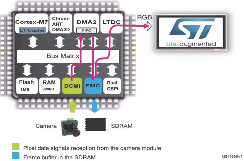

The frame data flow is like (Page 56 in AN5020)
Both DCMI and LTDC uses the same frame buffer.

There are a lot of competitors in that design: LTDC and DMA2 (for SDRAM), and DCMI as well. The fact is that DCMI is stalled when DMA2 is accessing the SDRAM (which could be stalled as well by LTDC access, and maybe SDRAM refresh).
One big issue (I already met using STM32f476) is that DCMI output FIFO (to AHB) is only 4 x 32-bit words. At the speed of pixels, this leaves almost no room for stalling DCMI transfer to DMA2.
Using SRAM for unloading DCMI data might not be an option. When you need SDRAM for holding big buffers, use another DMA from SRAM to SDRAM. This is the way I solved this problem on F476: using SRAM as FIFO between DCMI and SDRAM.
