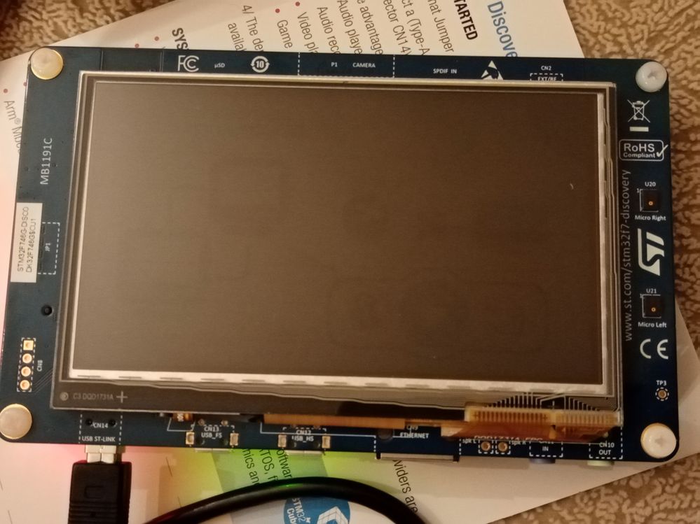

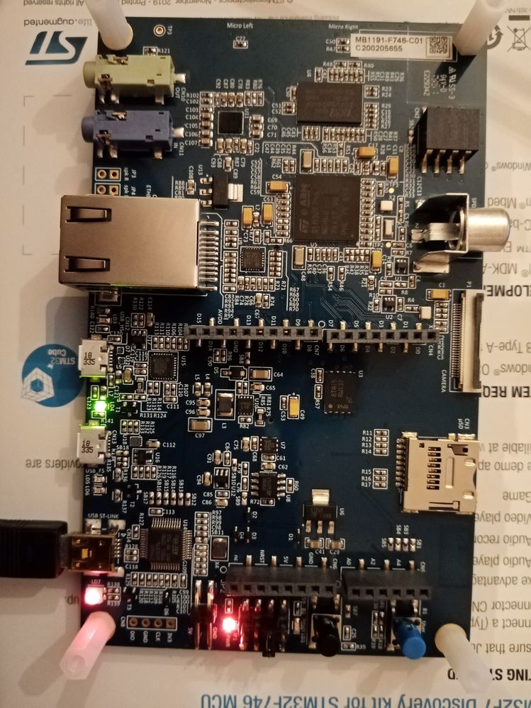

LD7 is red, LD2 is red and the LD4 is green. But the screen brightness is really almost dark! and really difficult to see applications lists.
Please find the attachments.

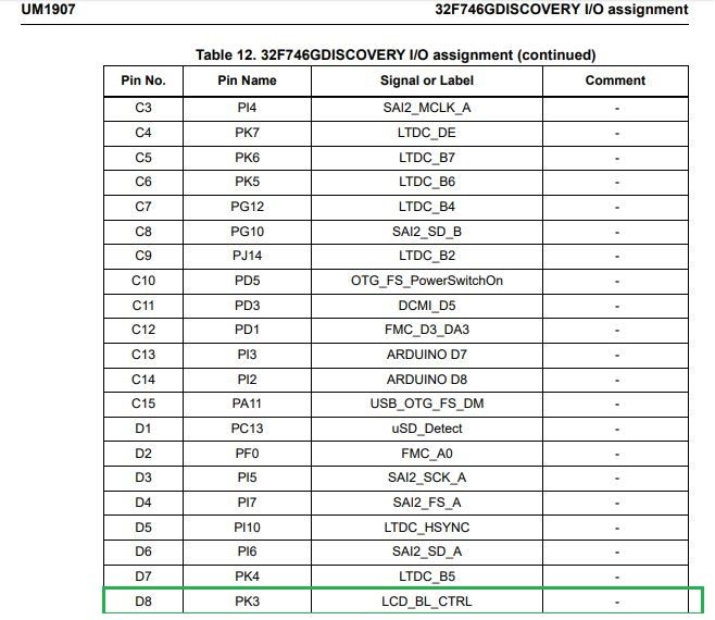

Configure the LCD back-light control (LCD_BL_CTRL) via PK3 pin. (You can check the STM32F746 schematic). Enable the LCD display using the BSP_LCD_DisplayOn() function:
STM32Cube_FW_F7_V1.16.0\Drivers\BSP\STM32746G-Discovery\stm32746g_discovery_lcd.c
