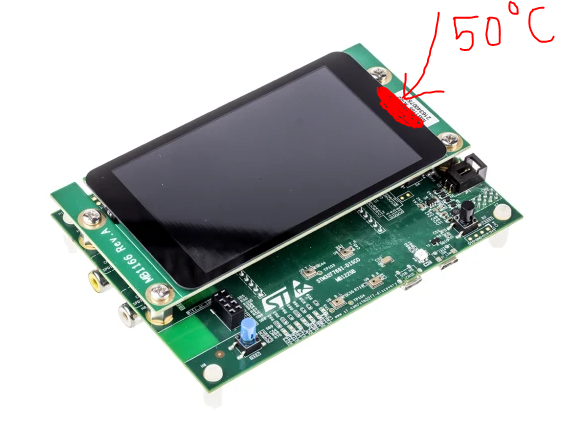

Can you please help me understand why the display of the STM32F769I-DISC board is not working anymore , it was fine 4 days ago , i recently installed the latest software packs and IDE's and tried to flash some custom application and the display was gone , I thought I was doing something wrong so I tried to flash the demo code from the st site still no luck , I have found that the display backlight is on and the right hand(please see the image highlighted in red) side is hot to touch (~45-60ish ).
I am very positive that there was no short circuit or physical damage to the board.
I want to know if the software configuration (from cube mx or touchgfx ) can damage the display ? If yes then please help me understand those scenarios . I will buy a new display but want to be sure that that new display also wont just stop working like this one did.

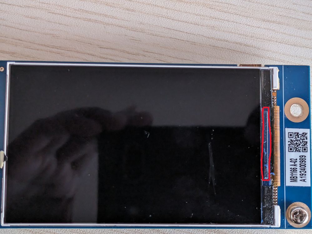

So i have tried to uploading one of the example project binaries and the display did not work . After a teardown i found this(highlighted in red boundary) whole region was hot (i could not keep my finger on there for long) but not burning.
Ordered a new display unit , hopefully i do not brick that too.
